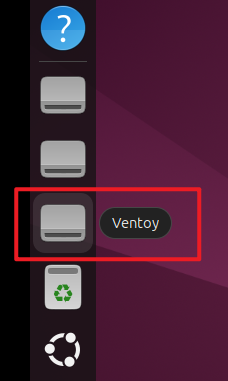

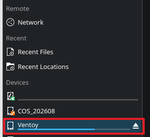

Since 1.1.18, Ventoy has made some targeted optimizations, so it works out of the box on mainstream desktop systems,
and the partition containing the ISO file can be accessed directly from the sidebar, as shown in the figures below.
